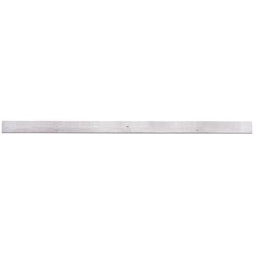

The Starrett 385 Series Steel Straight Edit with Bevel Edge is precision ground and nicely finished to rigid Starrett standards. It is unexcelled for drawing or scribing straight lines and checking surfaces for straightness. Its thickness and design permit it to retain shape and accuracy, but still be portable and easy to handle. The 380 and 385 Series in sizes 36" and longer is marked with arrows at two suspension points. If the straight edges are brought to the work and used on edge, they should be suspended at these two points to minimize deflection. Most jobs involve the use of straight edges in the flat position - and it is in this position that we check most stringently. 48" (1200mm).

- Thickness and design permit shape retention and accuracy while portable and easy-to-handle
- Beveled on one edge but not graduated
- Marked with arrows at two suspension points

- Steel Straight Edge, 48" (1200mm) Length, 7/32" (5.5mm) Thickness, 2-13/32" (60mm) Width
