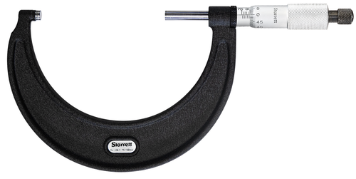

Starrett 436.1 Outside Mechanical Micrometers are the most popular precision micrometers used by skilled workmen worldwide. They are accurate, rugged, and easy to use. 436.1MXRL-50 features a 25-50mm range, 0.01mm graduations, and a flat, carbide anvil. The locknut is knurled ring type, with ratchet thimble. Produced with a black wrinkle frame finish. Furnished with a storage case. Standard Letter of Certification (SLC) is available as an optional add-on.
