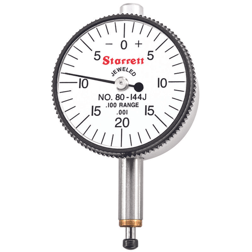

The Starrett 80 Series Miniature Dial Indicator is similar in design to AGD dial indicators. The miniature is built for gaging dimensions in tight places.

- Equipped with high precision, low friction movements, made in four models, all with frictionally adjustable bezels for quick, positive zero setting
- No-glare, white eggshell finish dials
- Black bezel, silver finish on case
- Furnished with balanced dial, jeweled bearings and lug-on-center back

- The case is light but sturdy, with a hardened, precision stainless steel rack that rides in bronze bushings

- Direct acting compression spring eliminates side friction

- Frictionally adjustable bezels for quick, positive zero setting

- Easy readability with the best, balanced style of graduation and number combination
- Feature 18:
- Balanced and tapered hands are easy to follow
- Feature 19:
- Furnished with balanced dial, jeweled bearings and lug-on-center back.
