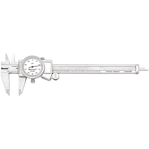

The Starrett 1202F Series Fractional Dial Calipers show measurements as fractions on the yellow outer scale with 1/64th inch graduation, and decimal measurements on the white inner scale with 1/100th inch graduations. This series provides quick, accurate measurement of outside dimensions, inside dimensions, and depth. This series features 0-6" fractional range. 6", Grad. in Fractions, in Fitted Case

- Provides quick, accurate measurement of O.D., I.D. and depth
- 1/64" graduations on the yellow outer scale, and .01" on the white inner scale
- Shows measurements as fractions
- Lock screws for sliding jaw and dial bezel
- Adjustable bezel
- Thumb-operated fine adjustment roll
- Covered rack depth rod
- Hardened stainless steel bar, measuring surfaces, rack, gears and depth rod
