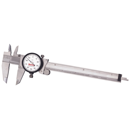

The American-made dial calipers are used by mechanics and toolmakers everywhere. Features include direct reading, ease-of-handling, reliability and accuracy making these one of the handiest measuring tools available. This series features white dial, 0 to 6" range, and .001" graduations.

- 120 Dial Caliper is one of the handiest measuring tools available
- This series features white dial, 0 to 6" range, and .001" graduations
- Knife-edge contacts for both inside and outside measurements
- One hand use with the thumb-operated, fi ne adjustment roll
- Hardened stainless steel bar, measuring surfaces, rack, gears and depth rod
- Positive, split-gear anti-backlash control
