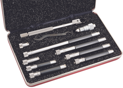

Starrett 121 tubular inside micrometers are designed for large internal measurements beyond the capacity of most other micrometers. Each set consists of a micrometer head mounted at the end of a tubular holder in which measuring rods can be inserted and adjusted to the desired size. Final size reading in thousandths of an inch (.001") is obtained using the micrometer head. In case with 1 Graduated Measuring Rod 32"-57".

- Micrometer Type
- Long Range Tubular Inside Micrometer
- Electronic or Mechanical
- Mechanical
- Range (in)
- 32 - 57"
- Graduations (in)
- .001"
- Movement of Screw
- 1"
- Accuracy of Mic Head
- +/- .0001"
- Accuracy of Assembled Tool
- +.0004"- .0000"

- Consists of a micrometer head mounted at the end of a tubular holder
- Rods and holder are light in weight
- Rod anvils are adjustable
- Quick, easy adjustment
- Rods and holder are made of rigid, steel tubing
- Hardened and ground anvils
- Insulated rod holder
- Nickel-plated finish
- Feature 09:
- Satin-chrome finish on micrometer head reading surfaces
- Feature 10:
- Rods are accurately graduated in inches - micrometer head in thousandths of an inch
