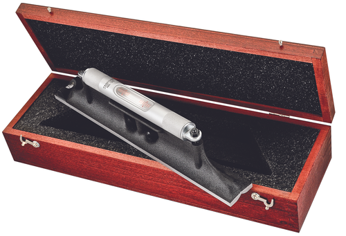

The Master Precision Level provides the ability to ensure a level machine setup, which in turn increases the efficiency of modern, high speed machinery.

- Specially designed to set up, check and test machinery of all types
- At-a-glance reading of the exact varation of machinery levelness
- Ground and graduated main vial of 10-second accuracy; one division equals 1/2 thousandth (0.0005) of an inch per foot, or 0.04mm per meter
- Main vials have seven graduations on each side of the bubble
- Auxiliary level vial shows lateral position and assists in horizontal setting
- Level vials are positioned so breakage is reduced to a minimum
- Fool-proof adjustment
- Special alloy iron used to obtain freedom from thermal effects

- Seasoned, machined castings
- Feature 11:
- Feature 12:
- Feature 13:
- All level bases are made from the finest quality seasoned cast iron and are precision-machined on the reference surface
- Feature 14:
- Scraped reference surface
