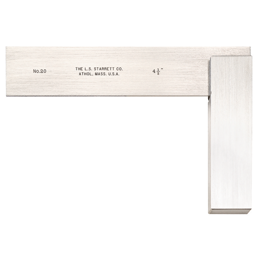

Master Precision Square is the finest precision-checking non-graduated square with accuracy to .0001" (0.0025mm) every 6" (150mm). This hardened steel square is used when extreme accuracy is required.

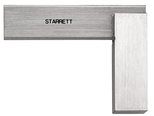

- The beams and blades are hardened, ground and lapped to ensure parallelism and straightness
- Made of high quality tool steel, with the finest of craftsmanship throughout
- The beam is grooved at the inner corner for clearance of burr or dirt
