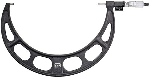

The Starrett 216 Digital Micrometer is a mechanical digital micrometer - simple to use even by the inexperienced. The anvil and spindle are sized at .250" (6.35mm). 175mm, 0.01mm Grad, Carbide Faces, Ratchet Stop, Lock Nut. Note: This item is discontinued. Please consider the recommended alternative listed above or contact our special order department at (978) 249-3551 x410 for more information.

- Accuracy (mm):
- +/-.005mm
- Anvil Type:
- Flat

- This is the Starrett mechanical digital micrometer - simple to use even by the inexperienced
- Clear, easily read numbers reduce errors
- Balanced frame design for comfortable and accurate measuring
- Gracefully designed tapered frame for use in narrow slots and tight places
- Carbide Measuring Faces
- Micro-lapped measuring faces
- Starrett no-glare satin chrome finish on thimble and sleeve
- No-glare black finish on the frame

- The anvil and spindle are sized at .250" (6.35mm)

- .001" or .01mm is read directly from the counter

- .0001" or .001mm is read from the vernier scale on the micrometer sleeve
- Graduations (mm):
- 0.01mm
- Lock Nut Type:
- Knurled Ring Type
- Micrometer Type:
- Outside

- Range (mm):
- 150-175mm
- Mechanical Counter Outside Micrometer, Ratchet Thimble, Carbide Anvil-Spindle, 150-175mm Range, 0.01mm

- Thimble Type:
- Ratchet

- Spindle Type:
- Flat
- Anvil/Spindle Material:
- Carbide Face
