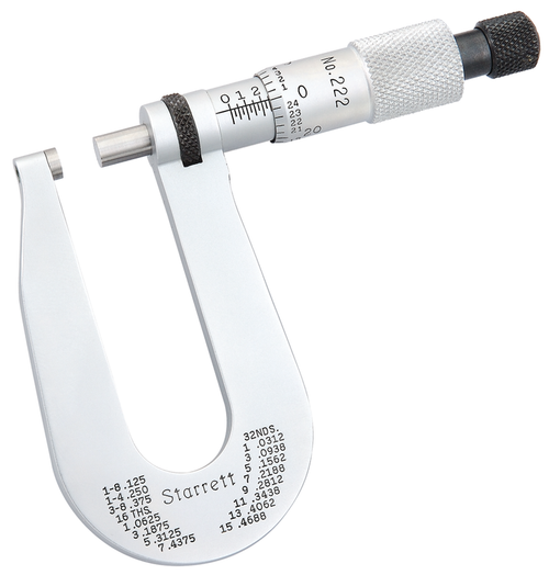

The Starrett 222 Sheet Metal Micrometer reaches over the edge of sheet metal and takes measurements away from the edge toward the center. Also for other gaging jobs where a deep throat micrometer is needed. Rounded anvil on 1" (25mm) size gives a point contact for more accurate gaging; flat anvil is also available. The 1/2" and 13mm micrometers have satin chrome frames; 1" and 25mm micrometer frames have black wrinkle finish. 1", .001" Grad, Round Anvil, Carbide Anvil & Spindle, Ratchet Stop.

- Rigid one-piece frame of drop forged steel, ribbed for strength and stability
- Micro-lapped measuring face
- Starrett satin chrome finish - no glare - resists rust
- Combination ratchet and speeder for uniform pressure and quicker adjustment
