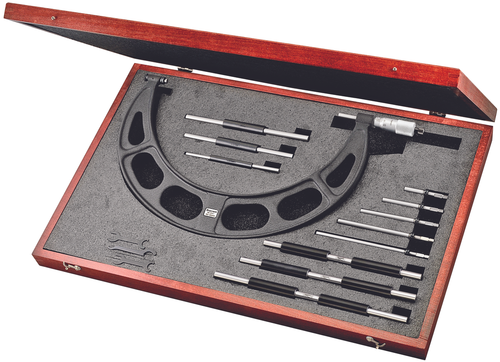

The Starrett 224.1, 224.1M Series Interchangeable Anvil Micrometers feature a wide range of measurement and flexibility. Each micrometer is equipped with a series of easily interchangeable anvils, thus providing the full range in steps of 1" or 25mm with a single micrometer. This model features 150-300mm Measuring Range. Smooth friction thimble for uniform pressure, the combination ratchet and speeder for uniform pressure and quicker adjustment, or a plain micrometer that depends on your own feel. Recommended for mechanics, automotive service and machine shops, toolrooms, inspection departments and wherever gaging involves a wide range of measurements.This model includes these standards: 150, 175, 200, 225, 250, and 275mm. 150-300mm, 0.01mm Grad.

- Suitable wrenches are furnished to make necessary adjustments
- Combination ratchet and speeder for uniform pressure and quicker adjustment
- Quick and easy sleeve adjustment
- Balanced frame and thimble design ensure easy handling and better readability
- Rigid and stable special cast iron frame with appropriate perforations for lightness and ribbed for strength and stability
- Micro-lapped measuring faces
- Large thimble diameter with distinct figures

- Interchangeable anvils for diversified gaging
- Feature 11:
- Each micrometer is equipped with a series of easily interchangeable anvils, providing the full range in steps of 25mm with a single micrometer
- Feature 12:
- These larger sizes have .300" (7.6mm) anvil and spindle diameters for ease of use on larger work

- Starrett No-glare satin chrome finish on thimble and sleeve minimizes annoying surface glare under bright lights and resists rust
