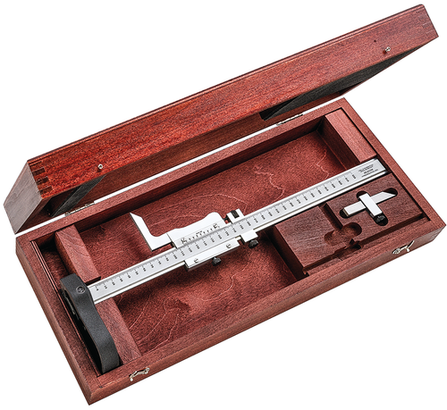

- 50-division vernier scales permits half as many bar graduations as single vernier tools. These graduations provide easy reading to 0.02mm
- Flush fitting of the vernier scales to the main scale eliminates parallax. Vernier scales are adjustable
- Black lines and figures against Starrett satin chrome finish make reading easy
- Scriber and base are designed for direct reading from zero (bottom of base)
- Quick-adjust release on the slide allows for fast positioning
- Extremely fine adjustments by a knob on the base isolating the column and slide from external pressures
- Additional remote fine adjustment located on top of the bar for sizes 36 (900mm) and larger
- Special master bar design and the balanced design and weight of the base eliminates vibration
- Feature 09:
- Master bars on models up to 24 and 600mm are hardened and stabilized
- Feature 10:
- Base is hardened, ground, and lapped square with the bar and has finger grooves to provide ease of movement
- Feature 11:
- Vertical bar is positioned near the center of the base for balance and stability
- Feature 12:
- Versatile tool will scribe lines, mount dial indicators or electronic probes, and accept depth attachments
