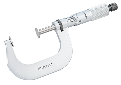

- Quick-reading figures - every thousandth numbered on inch tools
- Balanced frame and thimble design ensure easy handling and better readability
- Available in the 1" and 25mm sizes with rotating or non-rotating spindle
- Quick and easy adjustment
- Starrett satin chrome finish - no glare - resists rust
- The combination ratchet and speeder for uniform pressure and quicker adjustment on all sizes
- Feature 09:
- Gracefully designed tapered frame for use in narrow slots and tight places
- Feature 10:
- Anvil and spindle discs are 1/2" (12.7mm) diameter tapering to .015" (0.4mm) edge thickness making it possible to enter narrow grooves and recesses
- Feature 11:
- Rigid one-piece frame of drop forged steel
- Feature 12:
- Feature 13:
- Micro-lapped measuring faces
- Feature 14:
- This tool is accurate to .00015" or 0.003mm measuring over the whole surface and .0002" or 0.004mm measuring on the edges
