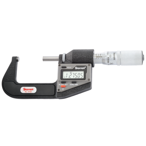

The Starrett 3732 Electronic Micrometer is a full-featured precision measuring tool built with customary Starrett quality and workmanship. The 3732 series includes a large, easy-to-read, high-contrast LCD digital readout for clear readings. With its automatic OFF functionality, smooth friction thimble for uniform pressure, and balanced frame design, Starrett products provide comfortable and accurate measuring Its no-glare satin chrome finish minimizes annoying surface glare under bright lights indoors. 2-3" (50.8-76.2 Approx mm), 0.00005" (0.001mm) Resolution.

- Micrometer Type
- Output:
- None
- China
- 049659624311
- $481.00
- $481.00
- Resolution (in):
- .00005"
- Resolution (mm):
- 0.001mm
- Battery Type:
- CR2032 lithium Battery (Qty 1), Included
- 9017.30.4000
- Outside
- Range (in)
- 2-3"
- Range (mm)
- 50.8-76mm
- Resolution (in)
- .00005"
- Resolution (mm)
- 0.001mm
- Accuracy (in)
- +/- .0001"
- Accuracy (mm)
- +/- .003mm
- Output
- None
- Anvil Type
- Flat
- Spindle Type
- Flat
- Anvil/Spindle Material
- Carbide
- Lock Nut Type
- Knurled Ring Type

- Balanced frame design for comfortable and accurate measuring
- No-glare black wrinkle finish on frame
- Hard and stable one-piece friction thimble permits one-hand operation of micrometer and uniform contact pressure
- Ability to zero tool at any position as well as retain and return to the true zero reading of the micrometer
- Feature 09:
- One 3-volt battery included for extended usage
- Feature 10:
- Automatic OFF
- Feature 11:
- Measurement HOLD button
- Feature 12:
- Feature 13:
- PRESET button to install any reading at any position
- Feature 14:
- English/Metric models have inch graduations on shell and thimble and display English units at power up
