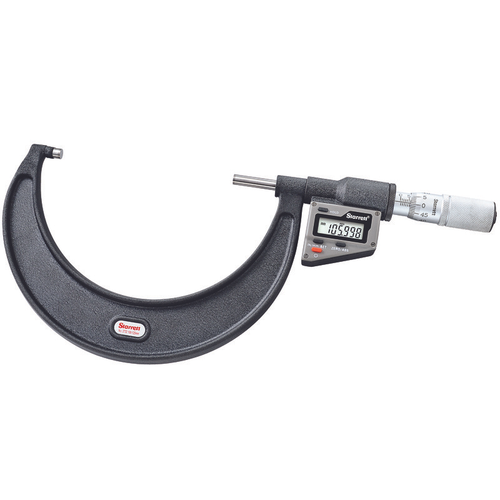

Balanced frame design for comfortable and accurate measuring
Large, easy-to-read, high-contrast LCD digital readout
Starrett No-glare satin chrome finish on thimble and sleeve minimizes annoying surface glare under bright lights indoors or filters out UV light
No-glare black wrinkle finish on frame
Hard and stable one-piece friction thimble permits one-hand operation of micrometer and uniform contact pressure
Ability to zero tool at any position as well as retain and return to the true zero reading of the micrometer
Ring-type knurled lock nut for quick and sure locking
Micro-lapped carbide measuring faces
Feature 09:
One 3-volt battery included for extended usage
Feature 10:
Automatic OFF
Feature 11:
Measurement HOLD button
Feature 12:
Inch/millimeter metric conversion provides simple, universal, standardized unit of measurement at any position
Feature 13:
PRESET button to install any reading at any position
Feature 14:
Metric/English (ME) models include inch and millimeter graduations on shell and thimble

The Starrett 3732 Electronic Micrometer is a full-featured precision measuring tool built with customary Starrett quality and workmanship. The 3732 series includes a large, easy-to-read, high-contrast LCD digital readout for clear readings. With its automatic OFF functionality, smooth friction thimble for uniform pressure, and balanced frame design, Starrett products provide comfortable and accurate measuring Its no-glare satin chrome finish minimizes annoying surface glare under bright lights indoors. 50-75mm (1.968-2.953 Approx Inch), 0.001mm (0.00005") Resolution.
The direct replacement is 3732.1MEXFL-75.
Difference between 3732MEXFL-75 and replacement 3732.1MEXFL-75:
  • Model 3732 has been upgraded to Model 3732.1 across the full product range. This update involves changes to internal components only, with no impact on functionality or design.
