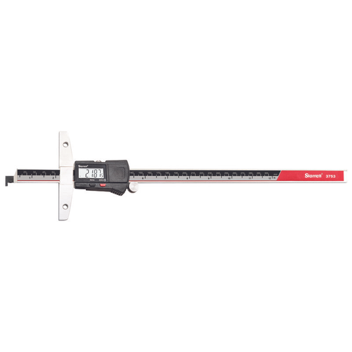

The Starrett 3753A Electronic Depth Gage is engineered for a high level of accuracy and long service life. Yet they are light and easy to use, with clear, easily-read numbers. This unit measures depths up to 6" (150mm). Additional ranges are also available in the Starrett catalog range.

- Clear, easily-read numbers, properly sized for the tool
- Hardened stainless steel body and slide for long life
- Fine adjustment thumb roll for precision measurements
- Lock to hold the slide in position
- Hardened base is 3-15/16" (99mm) long, but optional base extensions of 7" and 12" (175 and 300mm) are available.
- Spacing between holes is 2-3/4" (70mm).
- Hook attachment, to take readings from the edge of a work piece to edges of slots, grooves, shoulders, and other I.D. length dimensioning.
- The removable hook has the screw permanently attached to prevent loss.
- Feature 09:
- One-year minimum battery life with furnished 3-volt battery, CR2032
- Feature 10:
- Inch/millimeter conversion
- Feature 11:
- Zero at any position
- Feature 12:
- Manual ON/OFF plus a built in automatic OFF after 15 minutes of nonuse
