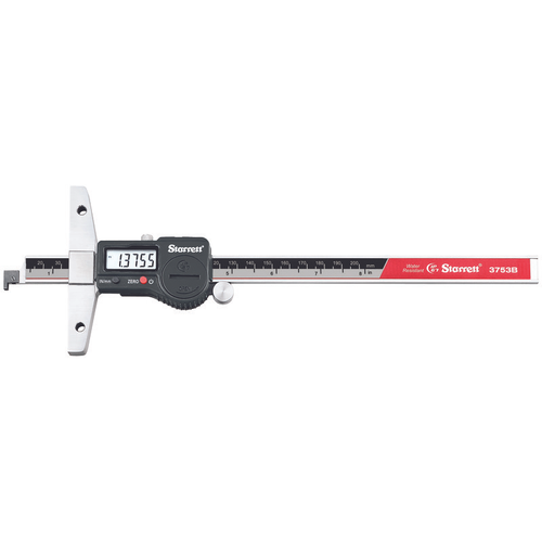

The 3753B Electronic Depth Gage is a versatile, easy-to-use tool for measuring depth, slot width, small section sizes and other applications. The gage provides an IP67 level of protection against foreign matter in a hostile shop environment and has an extra-large LCD for excellent readability. It also offers RS232 output to work with Datasure Wireless Systems as well as with cable-based products.

- Clear, easily-read numbers, properly sized for the tool
- Hardened stainless steel body and slide for long life
- Fine adjustment thumb roll for precision measurements
- Lock to hold the slide in position
- Hardened base is 3-15/16" (99mm) long, but optional base extensions of 7" and 12" (175 and 300mm) are available.
- Spacing between holes is 2-3/4" (70mm).
- Hook attachment, to take readings from the edge of a work piece to edges of slots, grooves, shoulders, and other I.D. length dimensioning.
- The removable hook has the screw permanently attached to prevent loss.
- Feature 09:
- One-year minimum battery life with furnished 3-volt battery, CR2033
- Feature 10:
- Inch/millimeter conversion
- Feature 11:
- Zero at any position
- Feature 12:
- Automatic shutoff after 30 minutes of non-use without loss of position upon reactivation
- Feature 13:
- Linear accuracy :+/- .001" (0.03mm)
- Feature 14:
- .0005" (0.010mm) resolution
