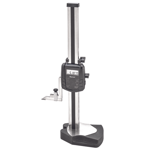

The Starrett 3754 Electronic Height Gage is a full featured, versatile and economic solution for most height measurement applications. All measuring information from these tools can be entered directly into Starrett Data Collection Systems for analysis, data collection and hard copy documentation. This model measures 0-24" (0-600mm)range. Also available in 0-12" (0-300mm) range.

- Large (9.65mm/3/8"), easy-to-read LCD display reads to 0.01mm or .0005"
- Instant unit conversion
- Carrier and scriber designed to read from zero
- Hold control feature retains a reading at any position
- Plus or minus indication allows reading in proper direction
- Ability to set zero at any position
- Manual on/off plus a built-in automatic off after 30 minutes of non-use to conserve battery life.
- Large positive action keypad
- Feature 09:
- Ability to retain and return to the true zero reading of the height gage
- Feature 10:
- PRESET button to install any reading at any position
- Feature 11:
- Ability to install minimum and maximum limits
- Feature 12:
- RS232 data output port
- Feature 13:
- Works well with Starrett DataSure Wireless Data Collection Systems
- Feature 14:
- 1-1/2+ years battery life. Two batteries furnished (CR2032).
- Feature 15:
- The base is well-balanced, hardened, ground and lapped.
