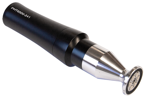

The 3821 produces non-destructive hardness testing results and is built for the shop floor. The 2 Kg probe is suitable for surfaces with an Ra below 200 μin. This hardness tester performs very well on thin materials. For example, it can successfully measure hardness on steel parts which are down to 0.08” (2mm) in thickness.

- Both ultrasonic (UCI) and dynamic (leeb) testing in one instrument
- Non-destructive testing
- For thin parts down to .08" (2mm)
- 2kg (3821) and 5kg (3822) probe
- Extremely versatile with many options and configurations to handle all types of hardness testing applications
