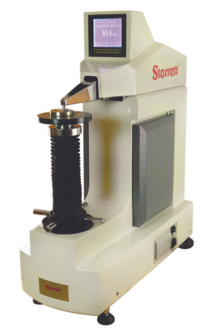

The 3831 Digital Rockwell Hardness Tester can be used directly to measure the most popular regular Rockwell hardness scales and it can quickly convert that hardness value into HB, HV, HLD, HK and many other scales. Loaded with many useful features such as ultra precise results, wide measuring range, scale and test force selectable, automatic main test force loading/unloading, high resolution digital display and USB data storage. The 3831 is suitable for testing hardness of carbon steel, alloy steel, cast iron, non-ferrous metals and engineering plastics.

- 60 Kgf, 100 Kgf, 150 Kgf
- Maximum Test Height
- 8.0" (203mm)
- Minor Load
- 10 Kgf
- Results Display
- Digital
- Test Force Application
- Dead Weight
- Test Force Control
- Motorized
- Throat Depth
- 7.8" (198mm)
- Unit Height/Width/Depth
- 22" (560mm) x 8" (200mm) x 31" (790mm)
- Unit Weight
- 175lbs Net / 250lbs Shipping

- Electronic
- Dead Weight Test Force Application
- Direct digital reading
- Engineered to obtain highly sensitive and accurate readings
- Perfect for laboratories, workshops, tool rooms, inspection labs, etc.
- Measuring Range: 8-650HBW
- Includes Certified Test Blocks, HRB 75-95, HRC 25-35, HRC 40-50, HRC 55-65
- Key Performance Parameters
- Preload - 98.1N - 10kgf
- Feature 09:
- Total test force - 588.4N(60kgf) 980.7N(100kgf) 1471N(150kgf),
- Feature 10:
- Scales: HRB,HRC,HRD,HRE,HRF,HRG,HRH,HRK,HRE,HRL,HRM,HRP,HRR,HRS,HRV
- Feature 11:
- Load dwell duration - 2 - 50s
- Feature 12:
- Resolution - 0.1HR
- Feature 13:
- Display - High definition backlight LCD
- Feature 14:
- Operation - Menu selectable push buttons
- Feature 15:
- Auxiliary functions Upper/lower limits setting & alarm, Scale conversions: HV & HB
- Feature 16:
- Data output: USB memory stick
- Feature 17:
- Testing Capacity - Vertical: 8.00" Throat Depth: 7.87"
- Feature 18:
- Power supply - single phase, AC, 110V, 50 - 60Hz, 4A
- Feature 19:
- Height: 22.04", Width: 8.07" , Depth: 31.49" , Weight: 175lbs (80kg)
- Feature 20:
- Included Accessories: Large Anvil, Small Diameter Anvil, V-shaped Anvil, 120 deg. Diamond Indentor, 1/16" Carbide Ball indentor, Storage Box
- Hardness Scale:
- Rockwell
- Major Load:
- Maximum Test Height:
- 8.0" (203mm)
