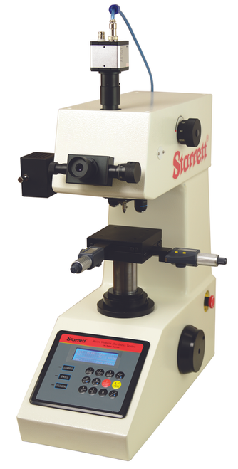

The 3840A Micro Vickers hardness tester is a precise testing system suitable for hardness analysis of metallic specimens in metallography laboratories or production environments. The Starrett micro-vickers hardness testers are versatile and user-friendly systems, designed for the accurate hardness testing of small precision parts, thin materials, coatings, wires and case depth determinations. The Starrett 3840A micro-vickers hardness testers include Video Cam, Adapter, USB Output Cable and Manual Measurement software giving you the capabilities of machines that cost thousands more. The 3840A Micro Vickers hardness tester covesr the load range from 10g to 1kg.
3840A Micro Vickers Hardness Tester with Digicam - Manual Software

- Technical Features:
- Testing Range: 1HV~2967HV
- Test Force: 0.098N (10g), 0.246N (25g), 0.49N (50g), 0.98N (100g), 1.96N (200g), 4.90N (500g), 9.80N (1000g)
- Max Height of the Specimen: 70mm
- Max Distance from the Indenter Center to the Instrument Panel: 95mm
- Lens/indenters with: With Hand Turret
- Carriage Control: Automatic (loading /holding-up of the load/unloading)
- Feature 09:
- Amplification of the microscope: 100,400
- Feature 10:
- Dwell Time of the Test Force: (5-60)S
- Feature 11:
- Min. Graduation Value of the Testing Drum Wheel: 0.25um
- Feature 12:
- Dimension of the XY Table: 100 X 100mm
- Feature 13:
- Movement Field of the XY Table: 25 X 25mm
- Feature 14:
- Light source/Power Supply: 110/ 220V,60/50Hz/Cold Light Source
- Feature 15:
- Weight/Gross Weight:41.5kg Net Weight: 35kg
- Feature 16:
- Package Dimensions: 425-245-490mm
