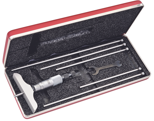

The Starrett 440, 440M, 445, 445M Series Depth Micrometer features a combination ratchet and speeder, ring-type locknut, ratchet stop and locknut. 0-75mm Range, 63.5mm Base, 3 Rods, Ratchet Stop, Lock Nut, Case.

- The depths of holes, slots, shoulders and projections can be measured with these fine tools
- 63.5mm (2-1/2") base and 3.2mm (1/8") diameter measuring rods
- Combination ratchet and speeder for uniform pressure and quicker adjustment
