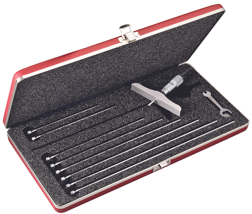

Micrometer Depth Gage, Ratchet Thimble, 0-225mm Range, 0.01mm

- MICROMETER DEPTH GAGE 0-225mm, 3" BASE
- Depth Micrometer Type:
- Mechanical

- Accuracy (mm):
- Mic head +/-.0025mm; Rods +/-.005mm
- Base Length (mm):
- 75mm
- 0049659522174
- 52217
- The depths of holes, slots, shoulders and projections can be measured with these fine tools
- 3" (75mm) base and 5/32" (4mm) diameter measuring rods
- Combination ratchet and speeder for uniform pressure and quicker adjustment
- Satin chrome reading surface is glare free and resists rust
- Graduations (mm):
- 0.01mm
- Lock Nut Type:
- Ring Type Knurled

- Measuring Rods (qty):
- 9
- Rod Diameter (mm):
- 4mm
