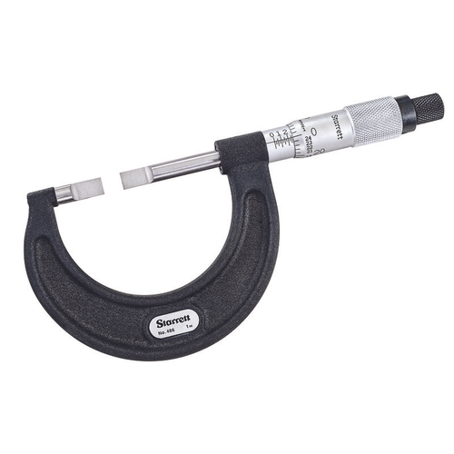

The Starrett 486 Blade Type Micrometer is another special function Starrett micrometer. It is designed for fast and accurate measurements of circular form tools, diameter and depth of narrow grooves, slots, keyways, recesses, and depths between lands and fins. 9-10" Range, .001" Grad.

- The blades are .030" (0.8mm) thick
- Blades will measure to 5/16" (8mm) depths
- Balanced frame and thimble design ensure easy handling and better readability
- Speeder for quicker adjustment on all sizes
- Non-rotating spindle prevents blade from turning in narrow slots or rolling off shoulder
- Starrett satin chrome finish - no glare - resists rust
- Rigid steel frame ribbed for extra strength
