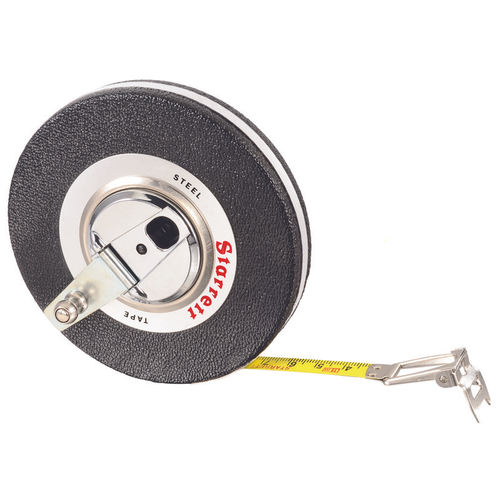

SPECIAL LONG TAPE 50FT DIAMETER One side in inch diameter (pi) measurements with 100th vernier scale and the other side is graduated in 1/8" and numbered in consecutive inches to each foot and repeat, with quick reading figures.

Features classic vinyl clad steel case
Manufactured with nylon rollers at case opening to reduce blade wear
Produced with easy-to-read graduations
Includes a folding hook ring

The closed reel steel long tape features a classic vinyl clad steel case design with a rugged rewind mechanism for single user convenience and nylon rollers at case opening to reduce blade wear and for sustained field use. Blades are produced with high visibility, easy-to-read graduations, and a folding hook ring. One side in inch diameter (pi) measurements with 100th vernier scale and the other side is graduated in 1/8" and numbered in consecutive inches to each foot and repeat.
Key Features
  • Dual-Sided Blade
    • One side graduated in 1/8" increments for standard linear measurements

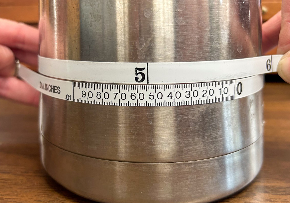

    • Reverse side designed for direct diameter measurement (Pi Tape)
  • Diameter Measurement Function
    • Measures diameter by wrapping around a circular object
    • Based on the formula:
      Diameter = Circumference ÷ π
    • Eliminates the need for manual calculation
  • Case Construction
    • Vinyl-clad steel closed reel
    • Manual rewind mechanism
    • Folding hook ring for secure positioning

Diameter Measurement (Pi Tape Side)
  1. Locate the side marked for diameter measurement
  2. Wrap the tape around the object (pipe, tree, or other round surface)
  3. Ensure the tape is flat and not twisted; keep edges parallel
  4. Read the diameter directly from the tape
