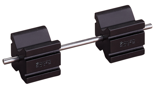

- Designed for versatility and accuracy
- All working surfaces are precision ground
- Two precision vees will hold round stock sizes from 1/4 to 1-3/4" (6.4-44mm) diameters
- Powerful, permanent magnet is controlled by a rotary switch
- All working surfaces are heat treated for long wear and stability
- Each block is 2-1/2" wide x 3" high x 3" long (63 x 75 x 75mm)
