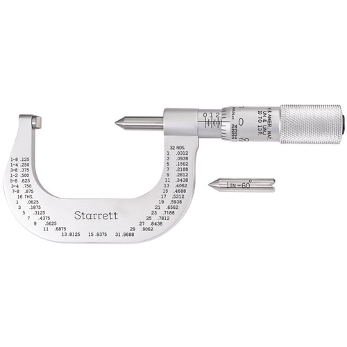

The Starrett 575 micrometers have a pointed spindle and a double V-anvil, both shaped to contact the screw thread. The micrometer reading therefore gives the pitch diameter. 0-1" Range, .001" Grad, 32-40 TPI.

- No glare Starrett satin chrome finish
- Advanced sleeve design with staggered lines and distinct figures for precise, easy readability
- Balanced frame design for comfortable, accurate measuring
- Tapered frame for narrow slots and tight places
- Furnished with fixed, non-rotating anvil
- One-piece frame of drop forged steel
- Quick and easy adjustment
- Feature 09:
- Design allows 50% to 75% contact with the thread to be measured, insuring contact with the pitch diameter at all times
- Feature 10:
- For measuring American Unified National series and Unified J series screw threads
- Feature 11:
- Series 585 micrometers come with a one-inch standard at no extra cost
