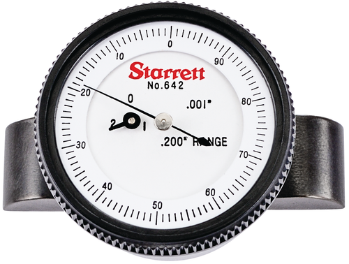

The Starrett 642 Top Reading Dial Depth Gage uses the back-plunger indicator to provide an upward-facing dial for easier readout. The operator selects the extension and contact point required, zeros the tool on a master and then reads any deviation of the work directly on the dial. .001" Grad, 4" Base with Extensions and Case.

- Indicator does not have to be repositioned to get the full range available
- 4" (100mm) base
- Two contacts and five extensions extend the range to 8.6" or 215mm
- Charts are supplied showing combinations of contacts and extensions required to achieve certain lengths
- Case is included
