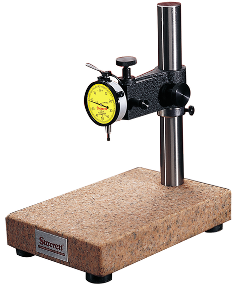

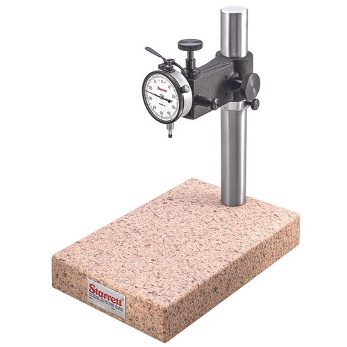

The Starrett 653 Individual Component is a bench-type comparator gage that is ruggedly built for in-process and final inspection work. The dial indicator can be adjusted vertically and locked in any position. A sliding ring with locking screw below the beam permits swinging the indicator to either side. The ring also acts as a safety device, preventing the beam from accidentally dropping. There is a fine adjustment on the beam for final indicator setting. The hand lifting lever on the indicator raises the spindle and releases it to contact the work. Left hand lever furnished unless otherwise specified. Maximum vertical capacity is 9-1/4" (235mm). Throat depth is 5" (125mm). Vertical indicator fine adjustment of up to 1/2" (12.7mm). Post diameter is 1-1/2". 653G Series have a Starrett Grade A, Crystal Pink Granite base, measuring 8" x 12" x 2" (200 x 300 x 50mm). Base is finished to an overall tolerance of .0001" (0.0025mm). Comparator with Granite Base, without Indicator.
