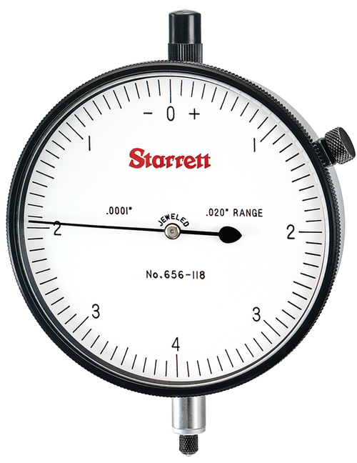

DIAL INDICATOR, 0 -.020", .0001" GRAD

Rugged and simple unit construction with a universally fitting design
Sharp bezel serrations for positive grip
Unbreakable crystal
Hardened stainless steel stem
No-glare satin finish on case
Hardened stainless steel rack and spindle
Massive bridge for rigid bearing support
Hardened stainless steel gears and pinions
Feature 09:
Non-reflecting white eggshell finish on dial
Feature 10:
Jewel Bearings
Feature 12:
Lug On Center Back Installed, Flat Back Included

Dial Indicator, 0-.020" Range, 0-4-0 Balanced Dial, .0001" Grads, .008" Range Per Rev, .375" Stem
The direct replacement is 655-341J.
[Discontinued 02/2023]
