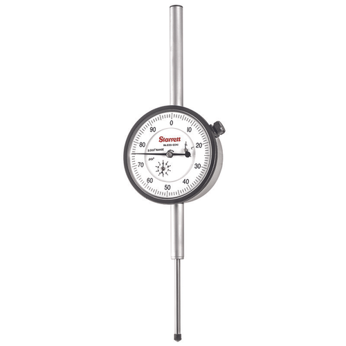

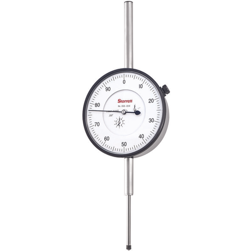

Graduations (in)
9017.30.8000
Indicator Group:
AGD 4
United States
.001"
Dial Reading
0-100
Dial Color
White
Style
Long Range
Total Range (in)
2.000"
Range One Rev. (in)
.100"
Stem Diameter (in)
.375"
Indicator Group
AGD 4
AGD and Starrett No.:
AGD 4, Starrett Model 656
Dial Color:
White
Dial Reading:
0-100
0049659537994
53799
Electronic or Mechanical:
Mechanical
Rugged and simple unit construction with a universally fitting design
Sharp bezel serrations for positive grip
Unbreakable crystal
Hardened stainless steel stem
No-glare satin finish on case
Hardened stainless steel rack and spindle
Massive bridge for rigid bearing support
Hardened stainless steel gears and pinions
Feature 09:
Non-reflecting white eggshell finish on dial
Feature 10:
Jewel Bearings
Feature 12:
Lug On Center Back Installed, Flat Back Included
Graduations (in):
.001"
https://s3.us-west-2.amazonaws.com/catsy.833/656-2041JcUSp1.tif
https://s3.us-west-2.amazonaws.com/catsy.833/Indicators+and+Gages+-+25+and+655+Dial+Indicator+with+Long+Range.tif
656-2041J Dial Indicator
Dial Indicator
Range One Rev. (in):
.100"
Dial Indicator, 0-2.000" Range, 0-100, .001" Grads, .100" Range Per Rev, .375" Stem Diameter
Stem Diameter (in):
.375"
Style:
Long Range
Total Range (in):
2.000"
2.7
15.3
5
$599.00
22400315
1.45
SDS Indicator:
656 Dial Indicators
DISC
Max. Range (in):
Min. Range (in):
656-6041J
Dimension Type:
Inch
Starrett 656 Series Dial Indicators with Long Range. These indicators have a shockless, hardened steel gear train and are furnished with jewel bearings and lug-on-center backs. Conforms to AGD specifications except for range. Stem cap supplied as standard. Furnished with continuous reading double dial with direct reading count hands. 2.000" Range, Dial Reading 0-100, .001" Grad.
The direct replacement is 656-6041J.
[Discontinued 10/2025]
