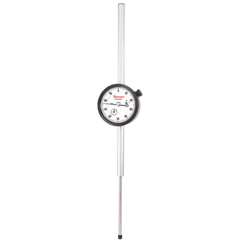

Rugged and simple unit construction with a universally fitting design
Sharp bezel serrations for positive grip
Unbreakable crystal
Hardened stainless steel stem
No-glare satin finish on case
Hardened stainless steel rack and spindle
Massive bridge for rigid bearing support
Hardened stainless steel gears and pinions
Feature 09:
Non-reflecting white eggshell finish on dial
Feature 10:
Jewel Bearings
Feature 12:
Lug On Center Back Installed, Flat Back Included

Dial Indicator, 0-3.000" Range, 0-100, .001" Grads, .100" Range Per Rev, .375" Stem Diameter

Starrett 656 Series Dial Indicators with Long Range. These indicators have a shockless, hardened steel gear train and are furnished with jewel bearings and lug-on-center backs. Conforms to AGD specifications except for range. Stem cap supplied as standard. Furnished with continuous reading double dial with direct reading count hands. 3.000" Range, Dial Reading 0-100, .001" Grad.
The direct replacement is 656-6041J.
[Discontinued 10/2025]
