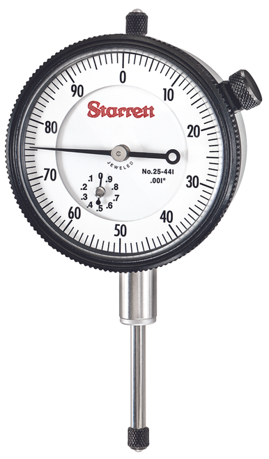

Rugged and simple unit construction with a universally fitting design
Sharp bezel serrations for positive grip
Unbreakable crystal
Hardened stainless steel stem
No-glare satin finish on case
Hardened stainless steel rack and spindle
Massive bridge for rigid bearing support
Hardened stainless steel gears and pinions
Feature 09:
Non-reflecting white eggshell finish on dial
Feature 10:
Jewel Bearings
Feature 12:
Lug On Center Back Installed, Flat Back Included

Dial Indicator, 0-1.000" Range, 0-100, .001" Grads, .100" Range Per Rev, .375" Stem Diameter

Starrett 656 Dial Indicators have a shockless, hardened steel gear train and jewel bearings. Features include a lug-on-center back. Balanced and tapered hands are easy to follow. This model features a 1.00" Measuring Range. If lift lever is desired, indicator must be ordered with case stem cap. 1.000" Range, Dial Reading 0-100, .001" Grad.
The direct replacement is 25-441J.
