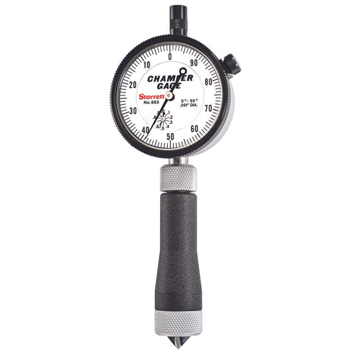

These gages directly measure the diameter of chamfered holes. No setting master is necessary. When the three-blade plunger is pressed against a fl at surface, the gage should read the set number stamped on the back of the indicator. In case of wear, the gage may be adjusted to read the proper number. 0-1/2" Range In case of wear, the gage may be adjusted to read the proper number.

- When the three-blade plunger is pressed against a flat surface, the gage should read the set number stamped on the back of the indicator
- No setting master is necessary
- Internal gages will measure the largest diameter of any chamfer that has an included angle within the range of angles printed on the dial face
