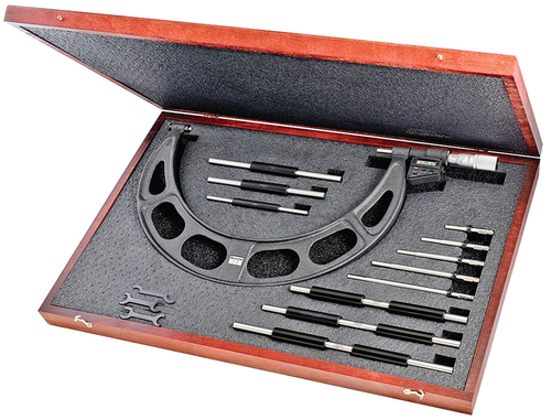

The Starrett 714.1 Series Electronic Interchangeable Anvil Micrometer with Standard Inch Graduations on Shell and Thimble features a 500-600mm and 19.680-23.620" measuring range, and 0.01mm resolution. 500-600mm Range, .0.001mm Res., Friction Thimble, Lock Nut.

- Accuracy (in):
- +/- .00035"
- Accuracy (mm):
- +/-.008mm
- Anvil Type:
- Flat

- Starrett no-glare satin chrome finish on thimble and sleeve
- Large, easy-to-read .275 (7mm) high contrast LCD digital readout
- Auto Off after 20 minutes of nonuse
- Inch/millimeter conversion on English versions
- Smooth friction thimble for uniform pressure
- Measurement HOLD button
- Zero at any position
- Feature 09:
- Retain and return to true zero reading
- Feature 10:
- Spindle lock
- Feature 11:
- Data Output
- Feature 12:
- Resolution: .00005" (0.001mm)
- Feature 13:
- Accuracy +/-.0001 (+/-.002mm)
- Feature 14:
- PRESET button to install any reading at any position
- Feature 15:
- Ability to install minimum and maximum limits
- Lock Nut Type:
- Knurled Ring Type
- Micrometer Type:
- Electronic Interchangeable Anvil Outside Micrometer
- https://s3.us-west-2.amazonaws.com/catsy.833/714MEJFLZcUSp1.tif
- https://s3.us-west-2.amazonaws.com/catsy.833/714.1AAFLZe72788cUSa1.tif

- Range (in):
- 19.680 - 23.620"
- Range (mm):
- 500-600mm

- Digital Interchangeable Anvil Micrometer, Friction Thimble, SPC Output, 0.001mm, 500-600mm Range

- Case Type:
- Wood case
- Max. Range (in):
- 23.62
- Max. Range (mm):
- 600
- Min. Range (in):
- 19.68
- Min. Range (mm):
- 500
- Spindle Type:
- Flat
- Anvil/Spindle Material:
- Steel
