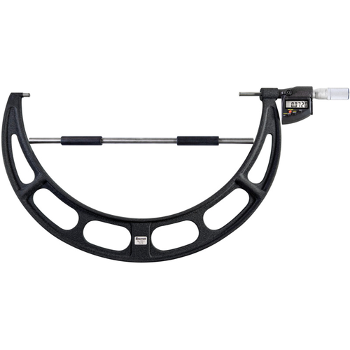

12-13" Range, .00005" Resolution, Outside Electronic Micrometer with Friction Thimble, Carbide Anvil, and SPC Output
