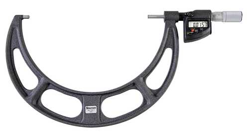

Starrett no-glare satin chrome finish on thimble and sleeve
Micro-lapped carbide measuring faces
Large, easy-to-read .275 (7mm) high contrast LCD digital readout
Balanced and tapered frame
Extremely hard and stable one-piece spindle
Auto Off after 20 minutes of nonuse
Inch/millimeter conversion on English versions
Smooth friction thimble for uniform pressure
Feature 09:
Measurement HOLD button
Feature 10:
Zero at any position
Feature 11:
Retain and return to true zero reading
Feature 12:
Spindle lock
Feature 13:
Data Output
Feature 14:
Resolution: .00005" (0.001mm)
Feature 15:
Accuracy +/-.0001 (=+/-.002mm)
Feature 16:
PRESET button to install any reading at any position
Feature 17:
Ability to install minimum and maximum limits
Lock Nut Type:
Lever
Micrometer Type:
Electronic Outside

15 -16" Range, .00005" Resolution, Outside Electronic Micrometer with Friction Thimble, Carbide Anvil, and SPC Output
