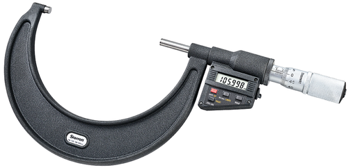

The Starrett 733 Electronic Micrometer with Output is a full-featured precision measuring tool built with customary Starrett quality and workmanship. It includes output capability for data transmission. The 733 series includes a large, easy-to-read, high-contrast LCD digital readout for clear readings. With its automatic OFF functionality, smooth friction thimble for uniform pressure, and balanced frame design, Starrett products provide comfortable and accurate measuring. Its no-glare satin chrome finish minimizes annoying surface glare under bright lights indoors. Starrett electronic micrometers guarantee a precise measurement at every position each and every time. 450-475mm Range, 0.001mm Resolution, with Case.
733MEXFLZ-475 Electronic Micrometer

- Accuracy (in):
- +/-.0003"
- Accuracy (mm):
- +/-.008mm
- Anvil Type:
- Flat

- Balanced frame design for comfortable and accurate measuring
- SPC Output
- Hard and stable one-piece friction thimble permits one-hand operation of micrometer and uniform contact pressure
- Ability to zero tool at any position as well as retain and return to the true zero reading of the micrometer

- One 3-volt battery included for extended usage
- Feature 10:
- Automatic OFF
- Feature 11:
- Measurement HOLD button
- Feature 12:
- Output capability
- Feature 13:
- Feature 14:
- PRESET button to install any reading at any position
- Feature 15:
- Metric/English (ME) models have mm graduations on shell and thimble and display metric units at power up
- Lock Nut Type:
- Knurled Ring Type
- Micrometer Type:
- Outside

- Range (in):
- 17.710-18.700"
- Range (mm):
- 450-475mm
- LCD Outside Micrometer, Friction Thimble, Carbide Anvil, SPC Output, 0.001mm Res., 450-475mm Range
- Optional Add-On
- Thimble Graduations:
- Metric
- Thimble Type:
- Friction
