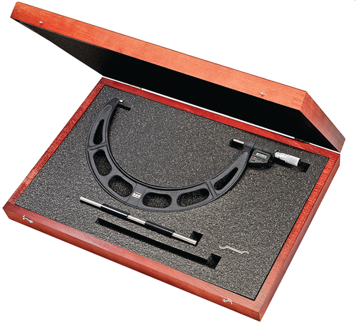

733MEXFLZ-525 Electronic Micrometer
$1,806.00
733MEXFLZ-525

Balanced frame design for comfortable and accurate measuring
SPC Output
Large, easy-to-read, high-contrast LCD digital readout
Starrett No-glare satin chrome finish on thimble and sleeve minimizes annoying surface glare under bright lights indoors or filters out UV light
No-glare black wrinkle finish on frame
Hard and stable one-piece friction thimble permits one-hand operation of micrometer and uniform contact pressure
Inch/millimeter metric conversion provides simple, universal, standardized unit of measurement at any position
Ring-type knurled lock nut for quick and sure locking
Feature 09:
Micro-lapped carbide measuring faces
Lock Nut Type:
Knurled Ring Type
Micrometer Type:
Outside
Range (in):
19.680-20.660"
Range (mm):
500-525mm
LCD Outside Micrometer, Friction Thimble, Carbide Anvil, SPC Output, 0.001mm Res., 500-525mm Range

The Starrett 733 Electronic Micrometer with Output is a full-featured precision measuring tool built with customary Starrett quality and workmanship. It includes output capability for data transmission. The 733 series includes a large, easy-to-read, high-contrast LCD digital readout for clear readings. With its automatic OFF functionality, smooth friction thimble for uniform pressure, and balanced frame design, Starrett products provide comfortable and accurate measuring. Its no-glare satin chrome finish minimizes annoying surface glare under bright lights indoors. Starrett electronic micrometers guarantee a precise measurement at every position each and every time. 500-525mm Range, 0.001mm Resolution, with Case.
The direct replacement is 733.1MEXFLZ-525.
