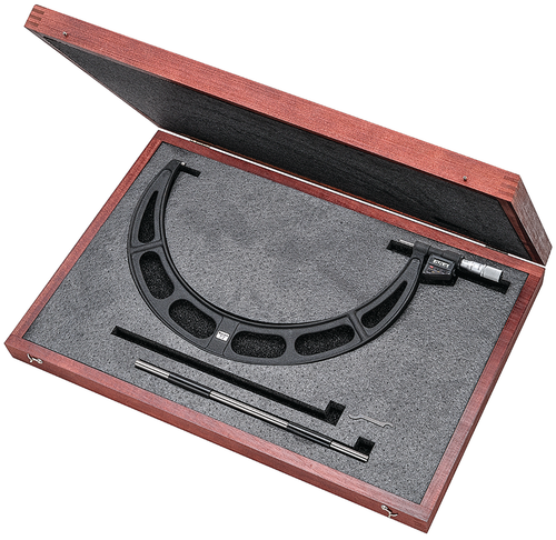

The Starrett 733 Electronic Micrometer with Output is a full-featured precision measuring tool built with customary Starrett quality and workmanship. It includes output capability for data transmission. The 733 series includes a large, easy-to-read, high-contrast LCD digital readout for clear readings. With its automatic OFF functionality, smooth friction thimble for uniform pressure, and balanced frame design, Starrett products provide comfortable and accurate measuring Its no-glare satin chrome finish minimizes annoying surface glare under bright lights indoors or filters out UV light. Starrett electronic micrometers guarantee a precise measurement at every position each and every time. 15-16" Range, .0001" Resolution, with Case time.
733XFLZ-16 Electronic Micrometer
