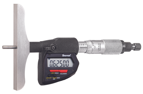

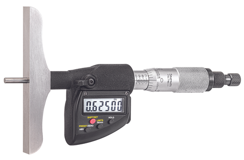

The Starrett 749.1 Electronic Depth Micrometer has a wide 0-12" (0-300mm) range for measuring the depth of most holes, slots, shoulders and projections. Ships in a protective case. [Discontinued 10/2025]

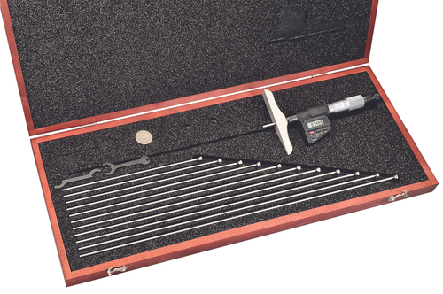

- Measuring Rods (qty)
- 12

- 19 Spec:
- Padded Case

- Starrett no-glare satin chrome finish on thimble and sleeve
- Large, easy-to-read .275 (7mm) high contrast LCD digital readout
- Auto Off after 20 minutes of nonuse
- Inch/millimeter conversion on English versions
- Measurement HOLD button
- Zero at any position
- Retain and return to true zero reading
- Feature 09:
- Spindle lock
- Feature 10:
- Data Output
- Feature 11:
- Resolution: .00005" (0.001mm)
- Feature 12:
- Accuracy +/-.0001 (+/-.002mm)
- Feature 13:
- PRESET button to install any reading at any position
- Feature 14:
- Ability to install minimum and maximum limits
- Feature 15:
- Base Length 4"/rod diameter 5/32"
