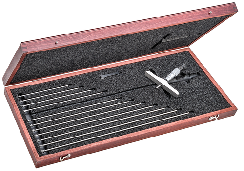

This depth micrometer has a wide 0-12"/0-300mm range for measuring the depth of most holes, slots, shoulders, and projections. The base shape design automatically positions the fingers so the base will be held in place evenly. The W749.1 model is a truly wireless micrometer depth gage, equipped to send data with the push of a button.

- Large easy to read high contrast LCD digital readout
- Starrett no-glare satin chrome finish on thimble and sleeve
- Balanced and tapered frame
- Extremely hard one-piece spindle
- Base length 4" (100mm)/Rod diameter 5/32" (4mm)
- Auto Off after 20 minutes of nonuse
- Inch/millimeter conversion
- Measurement HOLD button & Zero at any position
- Feature 09:
- Retain and return to true zero reading
- Feature 10:
- Accuracy +/-.0001" (+/- 0.002mm) & Resolution .00005" (0.001mm)
- Feature 11:
- Rechargeable battery
- Feature 12:
- Embedded radio allows to send data up to 30' with no end nodes or cables
