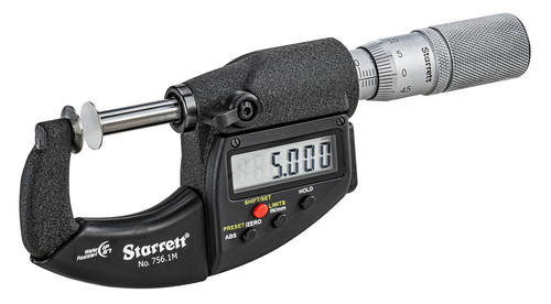

The Starrett 756.1 Series Electronic Disc-Type Micrometer with Rotating Spindle with Output is a full-featured precision measuring tool built with customary Starrett quality and workmanship. These tools are used to measure the thickness of work sections such as ribs, lands, fins, cutting edges on form tools, and chordal thickness of gear teeth. Because of their large anvil and spindle faces, the 1" and 25mm sizes are also useful for measuring the thickness of sheet materials like paper, cardboard, rubber, and plastics. Its no-glare satin chrome finish minimizes annoying surface glare under bright lights indoors or filters out UV light. With an accuracy of 0.00015"in measuring over the whole surface, Starrett electronic micrometers guarantee a precise measurement at every position each and every time. 0-1" (0-25mm) Range without Case. [Discontinued 10/2025]

- IP67 protection against coolants, water, chips, dust and dirt
- Starrett no-glare satin chrome finish on thimble and sleeve
- Large, easy-to-read .275 (7mm) high contrast LCD digital readout
- Auto Off after 20 minutes of nonuse
- Inch/millimeter conversion on English versions
- Smooth friction thimble for uniform pressure
- Measurement HOLD button
- Feature 09:
- Zero at any position
- Feature 10:
- Retain and return to true zero reading
- Feature 11:
- Spindle lock
- Feature 12:
- Data Output
- Feature 13:
- Resolution: .00005" (0.001mm)
- Feature 14:
- Accuracy +/-.0001 (+/-.002mm)
- Feature 15:
- PRESET button to install any reading at any position
- Feature 16:
- Ability to install minimum and maximum limits
