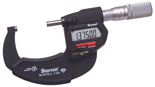

The Starrett W756.1 Series Wireless Disc-Type Micrometer with Rotating Spindle with Output is a full-featured precision measuring tool built with customary Starrett quality and workmanship. These tools are used to measure the thickness of work sections such as ribs, lands, fins, cutting edges on form tools, and chordal thickness of gear teeth. Because of their large anvil and spindle faces, the 1" and 25mm sizes are also useful for measuring the thickness of sheet materials like paper, cardboard, rubber, and plastics. Its no-glare satin chrome finish minimizes annoying surface glare under bright lights indoors or filters out UV light. With an accuracy of 0.0001"in measuring over the whole surface, Starrett electronic micrometers guarantee a precise measurement at every position each and every time. 1-2" (25-50mm) Range without Case.
Free Mobile Application
To use the wireless feature, download the free Datasure Mobile application from i-Tunes (iOS) or Play Store (Android devices). Your wireless Starrett tool will communicate to your mobile device from a distance of up to 30 feet. Send the data with the click of a button or your Starrett wireless gage. It is automatically collected on your device, and can be emailed. air-dropped or texted. The datasure app also provides lots of features and functions such as digital read out (DRO), formulas, unit conversions (SAE/mm), ability to name tools (connect 5 to 8 tools depending your on device capability), name parts being measured, set min/max levels, use device as a remote display, and much more. Download the brochure or give us a call for more details!
