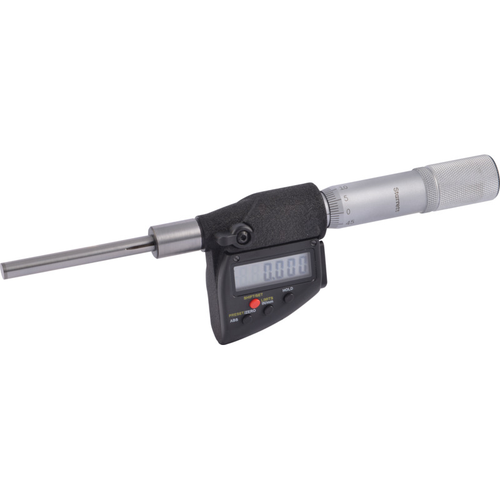

Starrett no-glare satin chrome finish on thimble and sleeve
Large, easy-to-read .275 (7mm) high contrast LCD digital readout
Extremely hard and stable one-piece spindle
Auto Off after 20 minutes of nonuse
Inch/millimeter conversion on English versions
Smooth friction thimble for uniform pressure
Measurement HOLD button
Zero at any position
Feature 09:
Retain and return to true zero reading
Feature 10:
Spindle lock
Feature 11:
Data Output
Feature 12:
Resolution: .00005" (0.001mm)
Feature 13:
Accuracy +/-.0001 (+/-.002mm)
Feature 14:
PRESET button to install any reading at any position
Feature 15:
Ability to install minimum and maximum limits
Lock Nut Type:
Lever Type
Micrometer Type:
Electronic Micrometer Head
https://s3.us-west-2.amazonaws.com/catsy.833/762.1MEXFL-25.tif

762.1 Electronic Digital Micrometer Heads

The Starrett 762.1MEXFL-25 Electronic Micrometer Head with Standard Millimeter Graduations on Shell and Thimble includes 0-25mm/0-1" range, friction thimble, lock nut, and carbide face. Featuring large digital readout that is easy to read and reduces errors. Conventional inch or millimeter graduations are standard. Heads are easy to handle with smooth friction thimble for uniform pressure. 0-25mm (0-1") Range, Friction Thimble, Lock Nut, Carbide Face.
