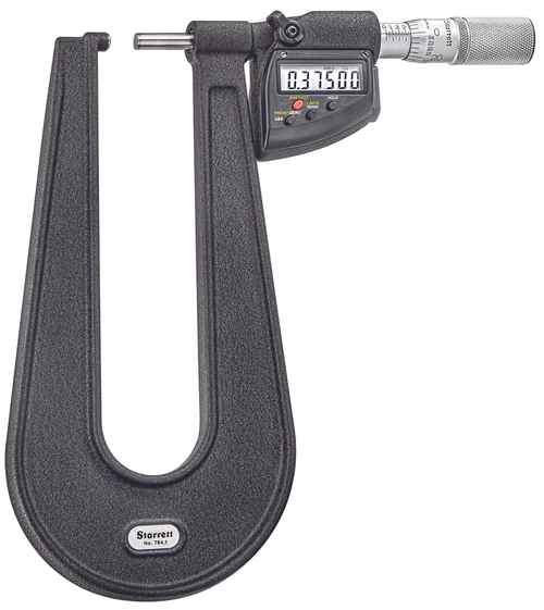

The Starrett 764.1 Series Electronic Multi-Anvil Micrometer is a full-featured precision measuring tool built with customary Starrett quality and workmanship. The 764 series includes a large, easy-to-read, high-contrast LCD digital readout for clear readings. Equipped with rounded anvils that gives a point contact for more accurate gaging. Includes 6" Throat Depth with Standard Inch Graduations on Shell and Thimble. Its no-glare satin chrome finish minimizes annoying surface glare under bright lights indoors or filters out UV light. This model features 0.00005"in & 0.001mm resolution and 0-1"in & 0-25mm measuring range. Starrett electronic micrometers guarantee a precise measurement at every position each and every time. 150mm Throat Depth, 0-25mm (0-1") Range, Round Anvil, with Output, Carbide Faces.

- Starrett no-glare satin chrome finish on thimble and sleeve
- Large, easy-to-read .275 (7mm) high contrast LCD digital readout
- Auto Off after 20 minutes of nonuse
- Inch/millimeter conversion on English versions
- Smooth friction thimble for uniform pressure
- Measurement HOLD button
- Zero at any position
- Feature 09:
- Retain and return to true zero reading
- Feature 10:
- Spindle lock
- Feature 11:
- Data Output
- Feature 12:
- Resolution: .00005" (0.001mm)
- Feature 13:
- Accuracy +/-.0001 (+/-.002mm)
- Feature 14:
- PRESET button to install any reading at any position
- Feature 15:
- Ability to install minimum and maximum limits
