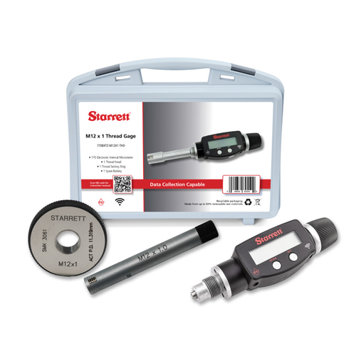

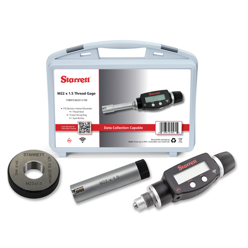

The Starrett 770BXT Series Electronic Thread Gage System delivers exact +/- measurement for thread milling operations. This allows machinists to measure exactly how much more material needs to be removed to achieve target thread diameter specification. The unit includes readout, head and setting ring for 1-12 thread size. It has 3 contact points. The head can be easily interchanged with additional thread size heads, and also with bore gage heads, allowing versatility to your bore and thread gage measurement process and a lower price point. The unit features IP67 level of protection against coolant, water, dust and dirt in hostile shop environments. It also has built-in wireless technology, ideal for data collection automation.
