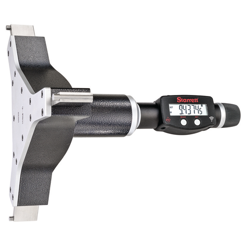

The Starrett 770BXT Series Electronic Internal Micrometer, with built-in Blue tooth technology, provides IP67 level of protection against coolant, water, dirt and dust in hostile shop environments. In addition, it offers extended travel, reducing the need to exchange anvils. The ground contact points seat the internal micrometer faster and more accurately than the spherical contacts found on other gages. The rugged and accurate internal micrometer is available individually or in sets from .080" (2mm) to 12" (300mm). 5-6" (125-150mm) Range, 3-Point Carbide Contact (300mm).

- Wide measurement range without changing anvils
- Carbide measuring faces on sizes above 5/16" (7.9mm) diameter
- Extensions available for deep holes
- Precision ratchet stop provides correct contact pressure for accurate readings
- Each micrometer bore gage with head comes with a wooden case, complete with setting ring, contacts, adjusting wrench, spare battery, and instructions
- IP67 level of protection against coolant, water, dirt and dust
- Large high-contrast LCD digital readout is easy to read and reduces error
- RS232 output
- Feature 09:
- Includes instant inch/millimeter conversion and preset + and - functions
- Feature 10:
- Proximity output with optional built-in Wireless
- Feature 11:
- Bi-directional communication
