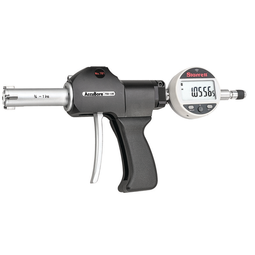

The Starrett AccuBore is a high-quality, trigger-activated, three-point contact bore gaging system with extended range and Bluetooth Data Output. Its convenient single-hand operation provides speed and control. It also features an easy-to-read digital display as well as mechanically-driven parallel anvils which extend simultaneously, establishing a more true alignment to the axis of the bore, providing consistent pressure and more accurate readings as opposed to models with spring-driven contacts. The gage also features a display with integrated LEDs tolerances that quickly indicate whether a bore measurement is within a preset tolerance window. Pistol Grip, 3/4-1" (20-25mm) Range.

- Single-hand operation with right- and left-hand viewing flexibility
- Large, easy-to-read digital display with integrated LEDs tolerances
- Enhanced wear life with carbide-faced contacts - available from 5/16" to 8"
- True alignment with mechanically-driven parallel anvils
- Push button inch/metric conversion
- Preset and preset recall
- Hold, max/min and zeroing capabilities
- Blind bore measurement is standard from .50" (12.7mm) and above
- Feature 09:
- Wireless Output capability for Statistical Process Control (SPC) analysis
