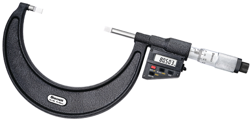

The Starrett 786.1 Electronic Blade-Type Micrometer with Non-Rotating Spindle With Output is a full-featured precision measuring tool built with customary Starrett quality and workmanship. The 786 series includes a large, easy-to-read, high-contrast LCD digital readout for clear readings and a speeder for quicker adjustment on all sizes. The non-rotating spindle prevents blade from turning in narrow slots or rolling off shoulder. Its no-glare satin chrome finish minimizes annoying surface glare under bright lights indoors or filters out UV light. This product features output capability for data transmission. Starrett electronic micrometers guarantee a precise measurement at every position each and every time. 75-100mm Range, 0.001mm Resolution time.

- Starrett no-glare satin chrome finish on thimble and sleeve
- Large, easy-to-read .275 (7mm) high contrast LCD digital readout
- Attractive no glare black wrinkle finish on the frame
- Auto Off after 20 minutes of nonuse
- Inch/millimeter conversion on English versions
- Speeder for quick adjustment and uniform pressure
- Measurement HOLD button
- Zero at any position
- Feature 09:
- Retain and return to true zero reading
- Feature 10:
- .030 Blade Thickness
- Feature 11:
- Data Output
- Feature 12:
- Resolution: .00005" (0.001mm)
- Feature 13:
- Accuracy +/-.0001 (+/-.002mm)
- Feature 14:
- PRESET button to install any reading at any position
- Feature 15:
- Ability to install minimum and maximum limits
- Graduations (in):
- .001"
